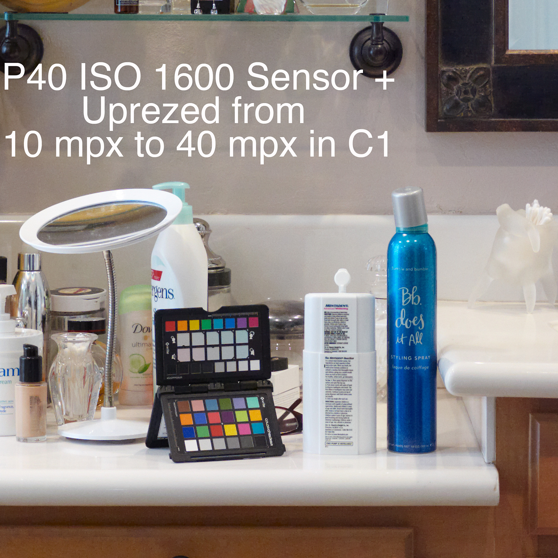

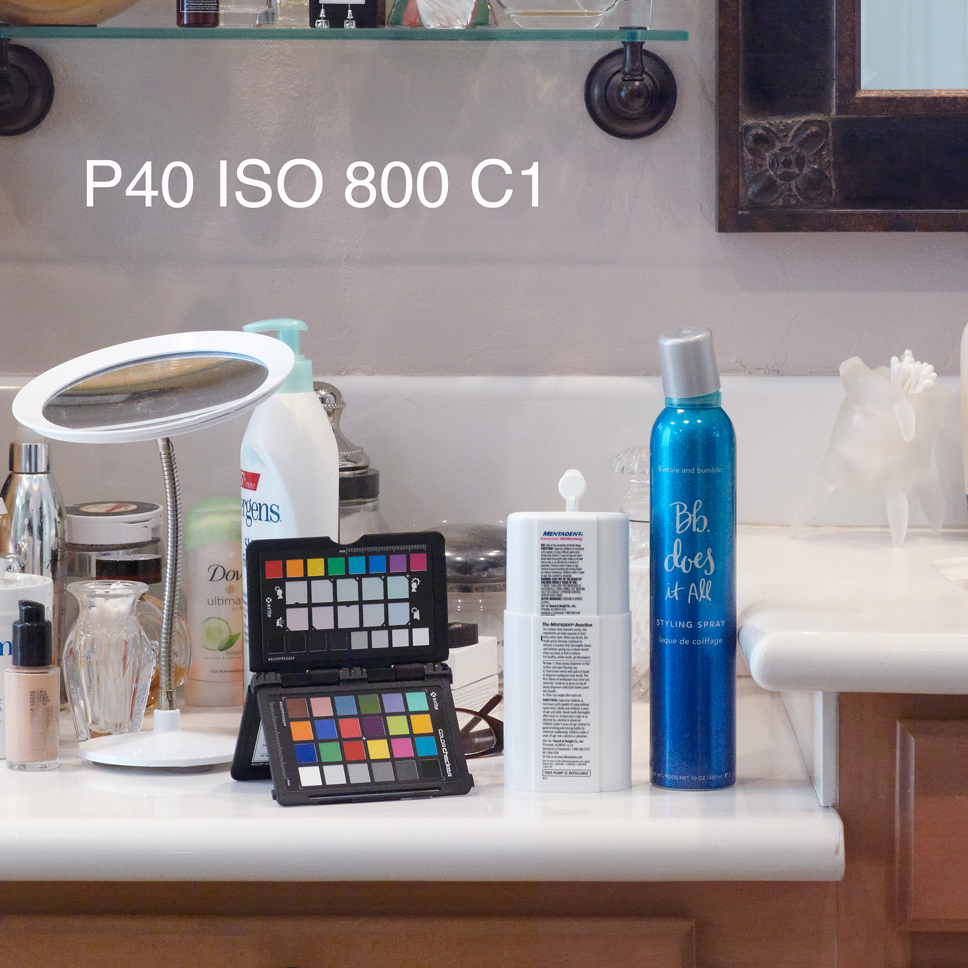

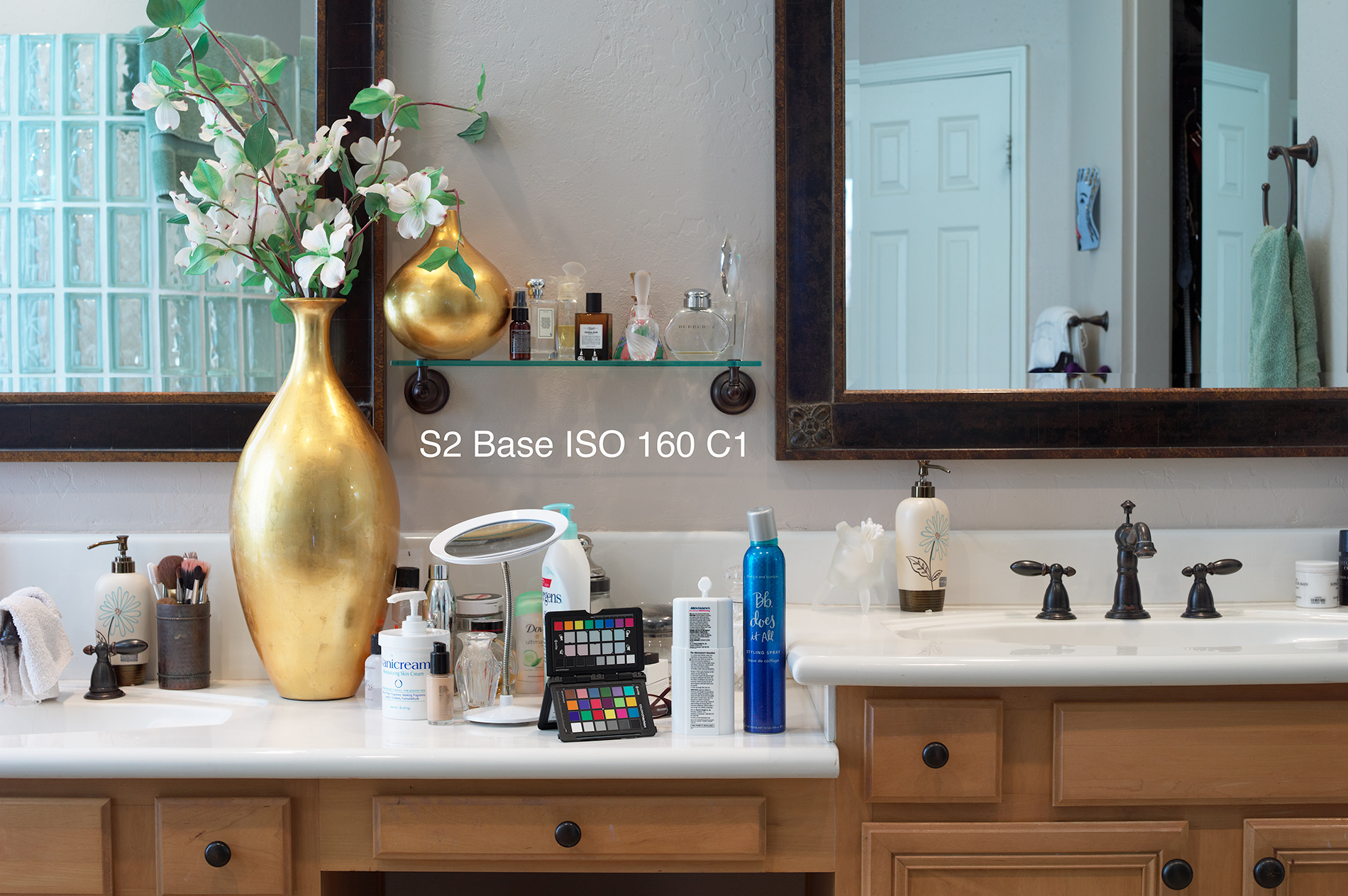

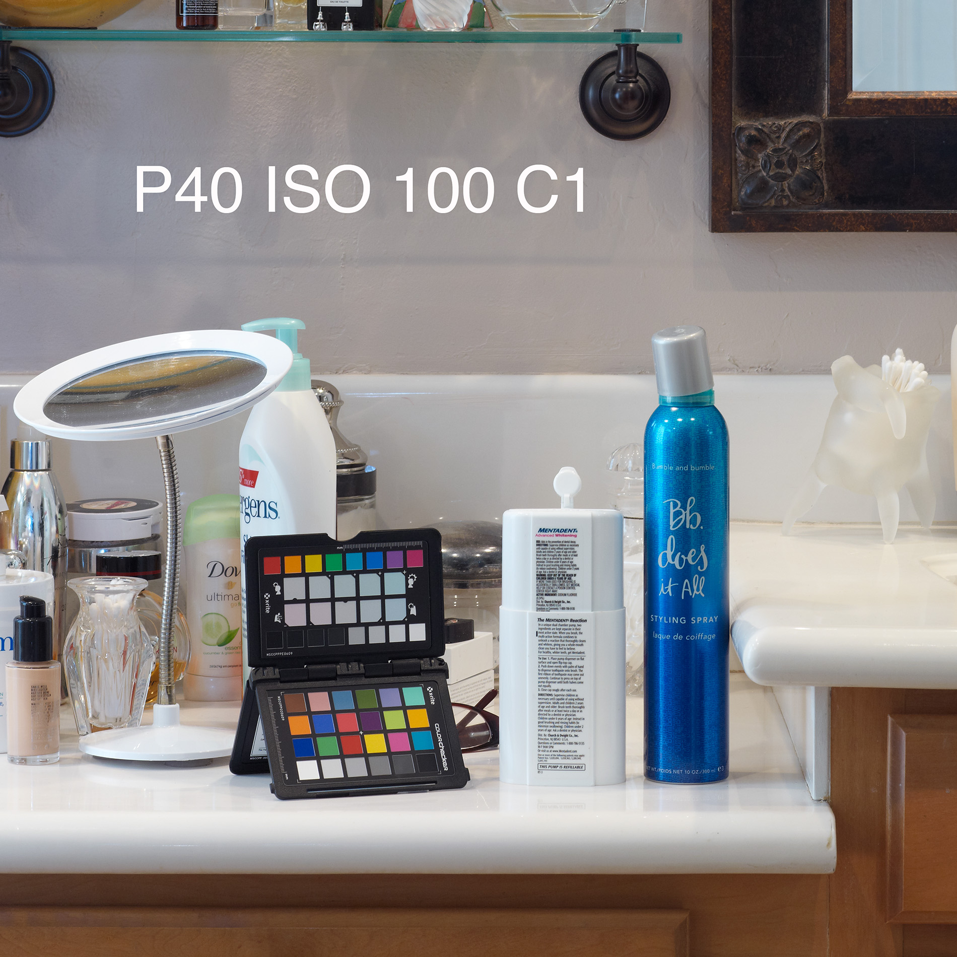

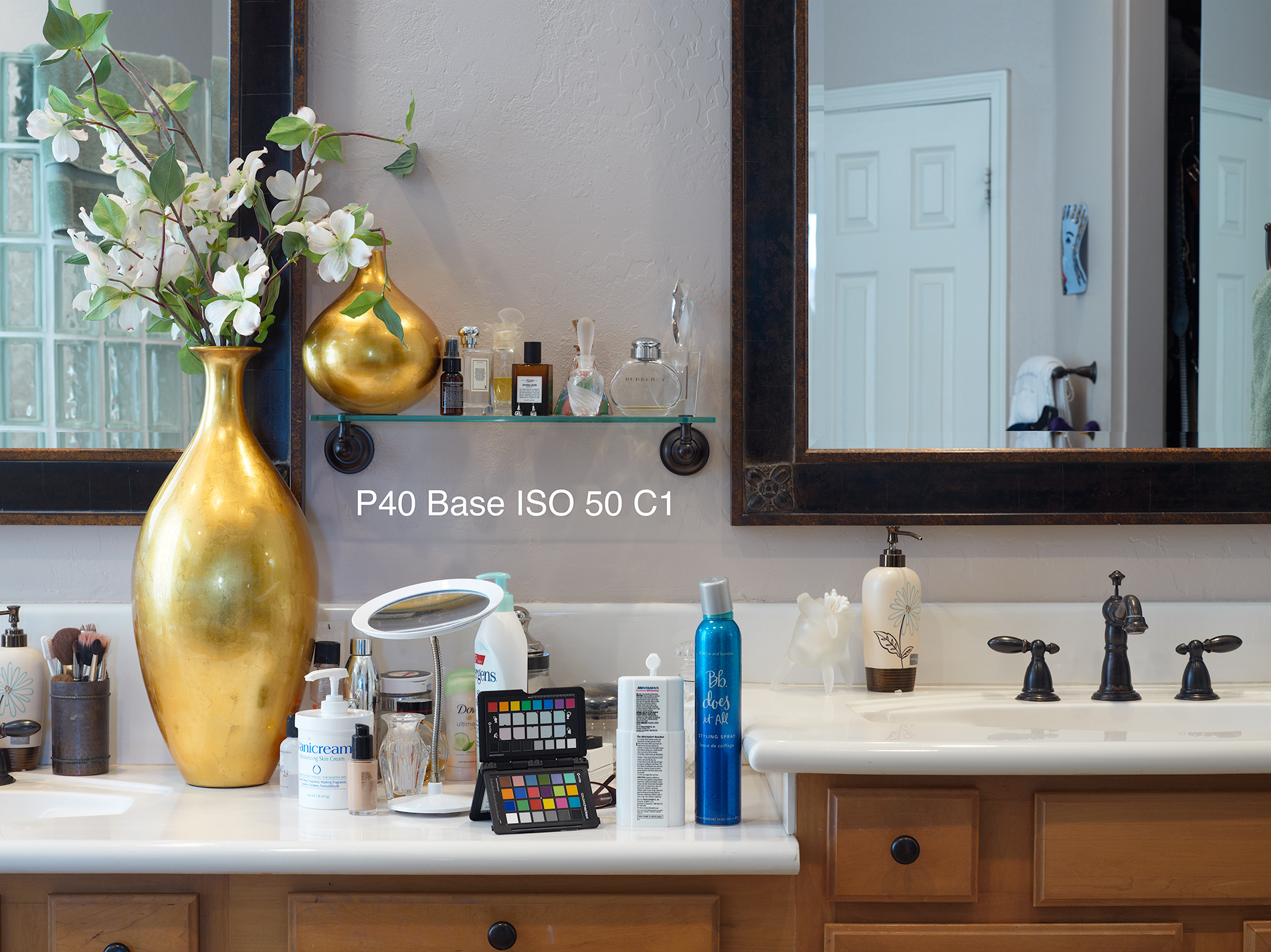

NOISE
Okay we are at the noise test here and we certainly will have the raws for both camera's available, the lighting is under tungsten with a slight amount of daylight coming from the left and both cams are set for tungsten ( as we all know tungsten is the worst for noise so that is how to test is the worst case scenario, no powder puffing going on here real working environment that we hit everyday) . For the S2 we have the Pulled 80 , 160, 320, 640 and 1250 ISO. The P40 + we have the whole series but not posting the whole set here but I did include the Sensor + raws in the folder as well. The P40+ we have 50, 100, 200, 400, 800 full resolution files posted plus I did a ISO 1600 Binned or Sensor Plus file uprezed back to 40 mpx in C1 posted as well.
I processed the whole series in C1 and WB for the P40 + and S2 on each series. Interesting note here as they are brought into C1 the P40 and S2 the Default is 25 luminance and the color starts at around 33 and than the color increases in value as the ISO go up. You need to watch this in C1 to see the increase in value. Now also the sharpness in C1 for the P40 goes down as the ISO goes up . So for this section i just let it do it's thing BUT you have the raws for both and I suggest you try it in C1 or LR for the S2 and actually maybe both to see how the noise falls. I can't simulate everyones work flow but can just give you a good basic idea what is going on. Please download and play around . I also took a pretty big section to show certain area's to look at so they are a little bigger than I wanted to go but get them to 100 percent in CS4 and look at but not limited to the corner of the mirror. The detail gets lost as the ISO goes up.
Another area to watch look under the top of the counter the wood and watch the noise increase. Also certainly watch the Color Checker in the grey tone area and finally I marked each file exactly the camera the ISO and than C1 as the processing software. I highly suggest this test in particular to download the raws and play in your favorite program at 100 percent and make evaluations yourself. My noise level of acceptance maybe different than yours .
Okay first the Full Frame Base ISO for the S2 ISO 160
Pulled ISO 80 . Here I had to decrease the exposure by 1 stop
Now let's move on to the P40+ Full frame image Base ISO 50
Guy Mancuso is offline   Reply With Quote

This image is a Binned or Sensor + ISO 1600 image which is a 10 mpx file than in C1 i increased the percentage by 200 percent to equal a 40 mpx file

Well I decided to be complete that I would also do the S2 in Light Room as well. As we have mentioned just not sure what we will see later on with raw processing final versions of LR beta and Profiles for C1 , so again save the raws for a later date to reprocess again to see if there are any changes in the noise dept. as well.
Here is the full frame Base ISO 160
