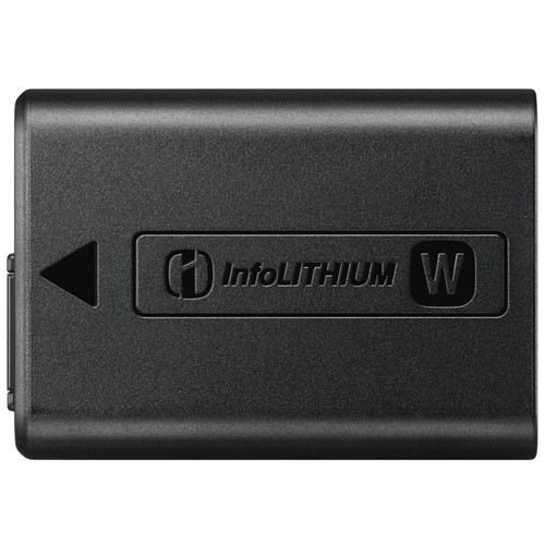

The GetDPI Photography Forums
Go Back   The GetDPI Photography Forums > Digital Camera Forum > Sony
Site Sponsors
Reply
Old 23rd January 2012   #1
Super Duper
Senior Member
Join Date: Apr 2008
Location: Netherlands
Posts: 7,522
Images: 59
Question Sony does a Panasonic?!
I have an odd experience with the Sony batteries.
The original ones that came with the NEX-5 and the 7 are doing well (on the 7).
I had bought two extra SONY NP-FW50 batteries in their original sealed covers from a vendor in HK (this was a while ago). Everything looks exactly the same as real thing. These have worked fine with the NEX-5.
But..when I try to use them on the NEX-7, after 1 minute or so, the camera says, "Incompatible battery" and refuses to function anymore. If I poer up and take a picture quickly, it is possible to take one snap before the message comes.
Two things appear to the case:
1. The "sealed" "originals" I bought were fake.
2. Sony NEX-7 does not appear to allow the use of 3rd party batteries (and/or Sony fakes).
Could anyone (I know it is only a few at the moment) check if #2 is the case?
Thanks!
Vivek is offline   Reply With Quote
Old 23rd January 2012   #2
Senior Member
Join Date: Jul 2010
Posts: 292
Re: Sony does a Panasonic?!
Quote:
Originally Posted by Vivek View Post
I have an odd experience with the Sony batteries.
The original ones that came with the NEX-5 and the 7 are doing well (on the 7).
I had bought two extra SONY NP-FW50 batteries in their original sealed covers from a vendor in HK (this was a while ago). Everything looks exactly the same as real thing. These have worked fine with the NEX-5.
But..when I try to use them on the NEX-7, after 1 minute or so, the camera says, "Incompatible battery" and refuses to function anymore. If I poer up and take a picture quickly, it is possible to take one snap before the message comes.
Two things appear to the case:
1. The "sealed" "originals" I bought were fake.
2. Sony NEX-7 does not appear to allow the use of 3rd party batteries (and/or Sony fakes).
Could anyone (I know it is only a few at the moment) check if #2 is the case?
Thanks!
the nex-5n and later nexs check to see if the battery is OEM. there may be fakes out there that bypass this check.
ken_vs_ryu is offline   Reply With Quote
Old 23rd January 2012   #3
Super Duper
Senior Member
Join Date: Apr 2008
Location: Netherlands
Posts: 7,522
Images: 59
Re: Sony does a Panasonic?!
That is OK (well, just like Panasonic, I do not like this sort of behaviors from camera companies) at least for 3rd party batteries. The ones in question look exactly as in this picture (from BH photo site) and cost the pretty much the same.
What is unclear also is that it takes the camera about a minute before coming up with the "incompatible battery" message while allowing even one picture to be taken.
Vivek is offline   Reply With Quote
Old 23rd January 2012   #4
k-hawinkler's Avatar
Join Date: Dec 2009
Posts: 135
Re: Sony does a Panasonic?!
Hi Vivek,
Thanks for the warning. That's good to know.
Where did you buy your extra battery?
I got an extra battery from B&H in New York.
So far, as far as I know, I haven't gotten any fakes of any kind from them.
I'll see what happens once I get the NEX-7.
Thanks again. Regards, K-H.
k-hawinkler is offline   Reply With Quote
Old 23rd January 2012   #5
Super Duper
Senior Member
Terry's Avatar
Join Date: Nov 2007
Location: New York City
Posts: 7,138
Images: 1142
Re: Sony does a Panasonic?!
Quote:
Originally Posted by Vivek View Post
That is OK (well, just like Panasonic, I do not like this sort of behaviors from camera companies) at least for 3rd party batteries. The ones in question look exactly as in this picture (from BH photo site) and cost the pretty much the same.
What is unclear also is that it takes the camera about a minute before coming up with the "incompatible battery" message while allowing even one picture to be taken.
Send the battery in to Sony as defective and see what they say.
__________________
terry
www.terrybanet.com
Terry is offline   Reply With Quote
Old 23rd January 2012   #6
Join Date: Dec 2008
Posts: 195
Images: 23
Re: Sony does a Panasonic?!
Quote:
Originally Posted by ken_vs_ryu View Post
the nex-5n and later nexs check to see if the battery is OEM. there may be fakes out there that bypass this check.
FYI I'm using Pearstone BPS-FW50 batteries (replaces Sony NP-FW50) from B&H and they work fine in the 5-n
Shac is offline   Reply With Quote
Old 23rd January 2012   #7
Super Duper
Senior Member
Godfrey's Avatar
Join Date: Jan 2009
Location: Near San Jose, California
Posts: 4,330
Re: Sony does a Panasonic?!
Quote:
Originally Posted by Vivek View Post
That is OK (well, just like Panasonic, I do not like this sort of behaviors from camera companies) at least for 3rd party batteries. ...
I guess I've just gotten tired of fussing over stuff like this. Whenever I buy a camera, I buy two spare OEM batteries and consider it part of the cost of the camera. I figure the battery is a much an essential part of the camera as the lens and I might as well just get the ones the manufacturer certifies as being appropriate.
I've only once completely worn out an OEM battery, where I've probably gone through a dozen aftermarket batteries in the past decade.
__________________
Godfrey - godfreydigiorgi.wordpress.com
Godfrey is offline   Reply With Quote
Old 24th January 2012   #8
Super Duper
Senior Member
Join Date: Apr 2008
Location: Netherlands
Posts: 7,522
Images: 59
Re: Sony does a Panasonic?!
In principle, I have 4 "original" Sony batteries. Two do not work. I am trying to dig out the information on the vendor and also send the whole thing to Sony.nl (likely I will hear from them it is not a "Sony.nl" product since it isn't purchased within Holland) since they are of no use to me.
Vivek is offline   Reply With Quote
Old 24th January 2012   #9
Join Date: Jan 2011
Posts: 60
Re: Sony does a Panasonic?!
If this is shown to be true with no get around then thats me out of Sony when my NEX 3 becomes 'uneconomic to repair, just renew'.....
It needs to be shouted out that Sony are a ROTTEN company with highly exploitive and questionable business/marketing policies. They have always charged the highest prices for their accessories and the old 'battery rippoff' made compulsory is, frankly, right up their street.....
.........It's not like it's a small difference in price!
Bugleone is offline   Reply With Quote
Old 24th January 2012   #10
New Member
Join Date: May 2011
Posts: 15
Re: Sony does a Panasonic?!
Batteries are faked, some very convincingly, for many manufacturers. The same goes for flash cards.
While they may work to some extent, there's no telling what a counterfeit accessory may do to your camera - especially one that is supplying it power.
I have no problem with Sony checking for cheap but convincing fakes (as opposed to alternate branding, within spec "clones"). Sony has had enough problems with their own batteries catching fire/exploding in laptops and phones to worry about knock-offs.
If they do turn out to be OEM batteries then Sony should replace them under warranty.
redsim74 is offline   Reply With Quote
Reply
Thread Tools
Display Modes
Posting Rules
You may not post new threads
You may not post replies
You may not post attachments
You may not edit your posts
BB code is On
Smilies are On
[IMG] code is On
HTML code is Off
Trackbacks are On
Pingbacks are On
Refbacks are On
All times are GMT -8. The time now is 09:26.
