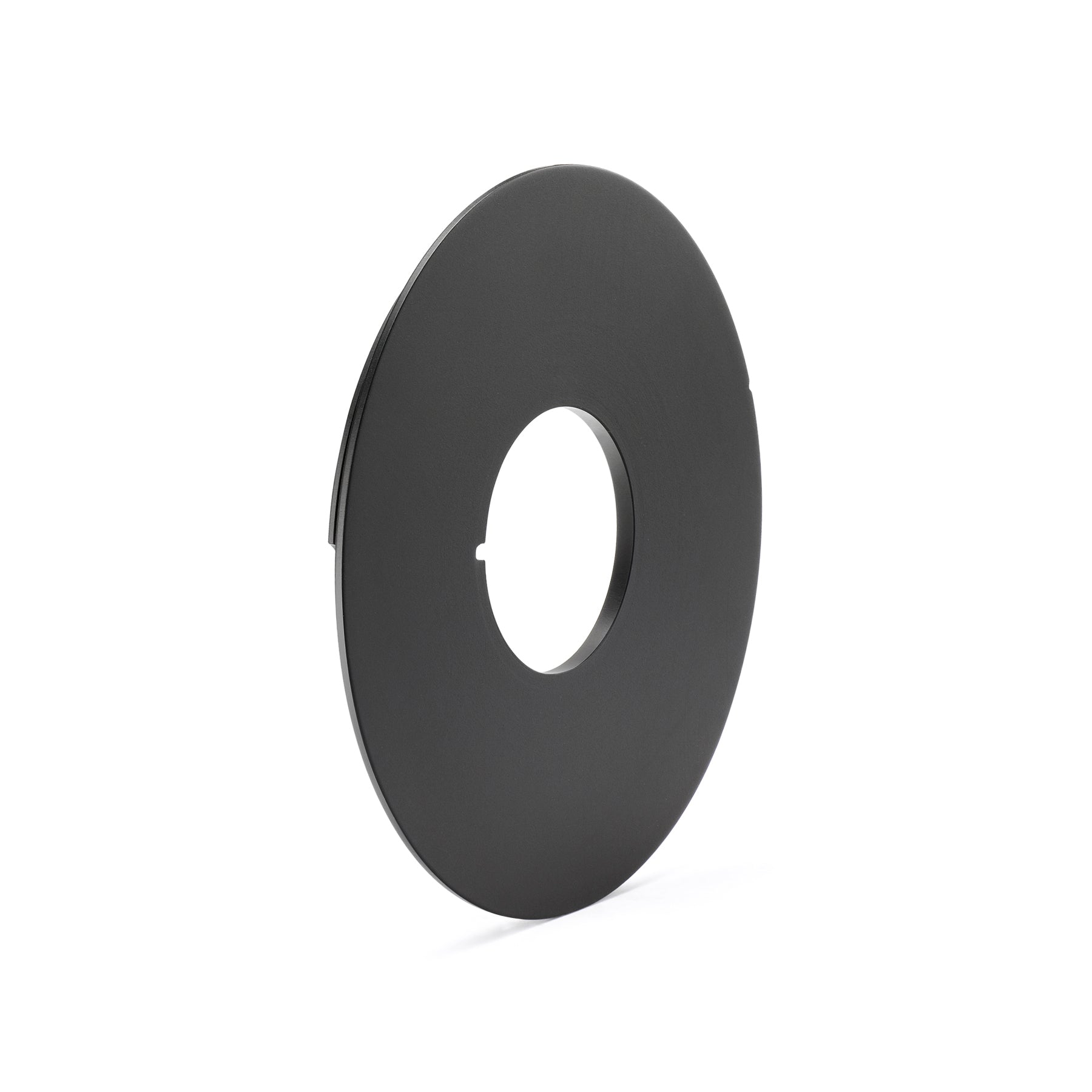

Thanks for chiming in @vjbelle, this is the type of reassurance I was looking for and it sounds like we're quite aligned in what we appreciate in a camera. Can I please ask what mount is fitted to your lenses and also, do you use any 6x4in Graduated Filters on the front of your lenses? If so, do you experience an issues with the bottom of the filter hitting the camera?
vjbelle
The mount fitted to all of my lenses is the Pico mount which is the only mount that can be used with the Pico camera. It is a new design with a quarter turn for locking/unlocking to the camera.
I do use 100mm ND filters and if I use my Schneider 72XL lens the filter can hit the top of the tilt mechanism because the lens fits so far back on the camera. I do not have this issue with any of my Rody lenses. You can see images of this from this link: https://www.getdpi.com/forum/index....o-lens-compatibility.76467/page-3#post-913807. Scroll around a little and you will see both an image with the 72mm and an image with my Rody 40mm.
In practical terms this limitation with the 72mm is fairly moot. I did increase the density of my ND to a '3' just to have a little more flexibility with the 72mm but in hindsight it really wasn't necessarry.
Victor B.
vjbelle
I don't know what you are referring to. All of my lenses including the 138 float were mounted by me. All of my lenses except for the 138 float are copal '0' lenses.
Victor B.
diggles
Thanks for your reply, can I ask how much it cost to have your lens mounted to B-Mount (Pico)?
The Pico uses a standard Copal 0 board. No need to send your lenses in to get them mounted because you can do it yourself.
