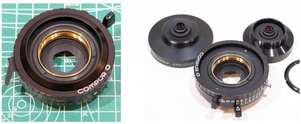

Here's a Compur 0 shutter into which I installed APO-Digitar 35/5.6 L-88 cells. In the picture at left, notice the shiny black raised rim. On the right, it's removed. It's just plastic and pops out. The front cell from the 35mm doesn't fit in the shutter until you remove the ring; then it fits fine. In the picture at right, you can see what I mean about the levers being positioned more intelligently. You can operate the aperture lever without having to fight with the shutter cocking lever, like you do on a Copal 0 shutter.
I don't use shutters anymore so I haven't figured out how to adjust the aperture, but it definitely can be done. Any Copal 0 shutter can take any cell that physically fits. If you figure out how to set the maximum aperture, you're good to go once you make yourself a label, or have someone do it.
If you can't figure out how to adjust the maximum aperture, a quick and dirty solution is to figure out what the position of the lever where the aperture is correct for that lens, and then stick on a new scale.
