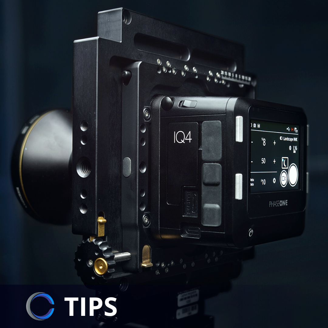

Hmm... Thanks for pointing this out. I'm a bit unclear about the process. It seems like when the electronic shutter setting is selected, some Phase backs still send a signal to activate the flash. So, if you use the shutter speeds mentioned in the article you can sync your flash? Does flash duration have to be considered? What is an example of how you use it?
Thanks!
cunim
Certainly not.
I wasn't aware that CI had actually documented this. It was my impression that it isn't supposed to work and I have no clue why it does, but I routinely use flash with ES on the IQ4. There is some flexibility around the times that Brad gives (e.g. sometimes a half second will work) but that doesn't matter in most cases. If it works with the IQ, I'll bet someone just needs to figure out the exposure timing on the 907. Note, this type of flash has limited application in that any ambient light will affect the long exposure.
